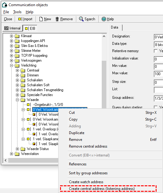

Hello TP,
You need to link this in 'Communication Objects'
you can add a listen-groupadress to another groupadres.
see picture
listening adress.png (15.75 KiB) 9768 keer bekeken

Hi Dré,
Hi Dré,
i've try your solution and and it works perfectly.
Thank you
Re: Display status of shutter in QuadClient
Remember that this also applies to the dimmers within Quad Client.
They will also just have a switching and dimming object to connect, both will require the same step as posted by Dré
